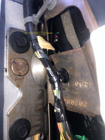

While removing a dealer installed tracking device tucked underneath the dash today I noticed four small wires that have been cut. These wires are behind the drivers AC vent. Anyone recognize these wires?

I am pretty sure that the difference between Nav & non Nav is just software & activation.
Unless your roof antenna is just a Puck, not a Shark Fin
With a Puck antenna, a GPS unit would be plugged into the back of the radio & it would be placed above the radio, near the center dash speaker, close to the windshield

Nope, not for upgrading Nav, as previously stated on the older radios it's a software activation. I believe those wires are aftermarket power wires of some kind and not original to the truck. I'd start pulling them out and see where they lead.

Thank you guys. I pulled the wires out only to find a second tracking device. Obviously not connected to anything due to cut wires. Can't afford to replace the radio right now so the amp draw search continues. I will be flying out of state next week and the truck will be parked for three days. Is pulling the radio fuse once parked a good idea to prevent a possible drained battery? I have a jump pack but would rather not drain the battery while parked, again.

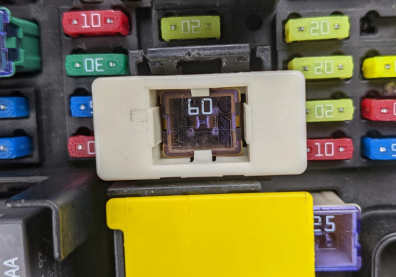

Would his 2016 Ram have a
IOD Fuse ? ( Ignition Off Drain )
questionable comment ?
Dodge hid one fuse that you probably missed. It's called the ignition-off draw (IOD) fuse, located in the inside fuse box, the Junction Block. Look under the panel at the far left end of the dash... The fuse is held inside a black colored fuse holder with tabs to make it easier to pull out of the block.
It may be a 60 amp fuse, like it was on the 2012 & earlier models

PS, those cut wires, did you put a meter on them to see if power?

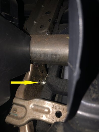

Update: While inspecting the wiring behind the radio and dash, noticed lots of dog hair and a ground wire that was not screwed tightly to the frame. Took a 10mm wrench and tightened snug. Pic was taken after tightening bolt/screw. Not sure if this is even related to the radio but it was loose. See pic below:

I also did not re-connect the Bordeaux colored Fakra connector which I believe to be the Cellular antenna (3G which is obsolete these days) in the event the air card was defective causing a short. One of these (or both) adjustments seem to have worked. Disconnected the negative battery cable, manually closed hood latch, removed under hood light and closed all doors for 1 hour before checking amp draw. Noticed a spark when attaching lead to battery terminal with an initial draw of 3.35 amps. After about 20 seconds the amp draw began to drop eventually stabilizing at 0.46-0.47 amps. Any thoughts or comments on this shade tree fix and/or diagnosis?

I did not test the wires before yanking the second tracking device but nice suggestion. I will remember to do this if there is a similar situation in the future. Thank you.

bad grounds will always cause problems. Glad you found it.
