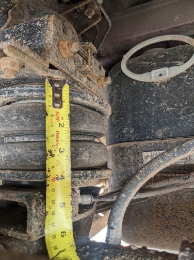

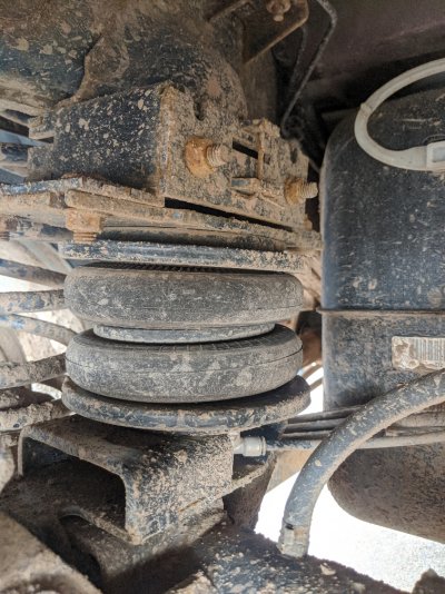

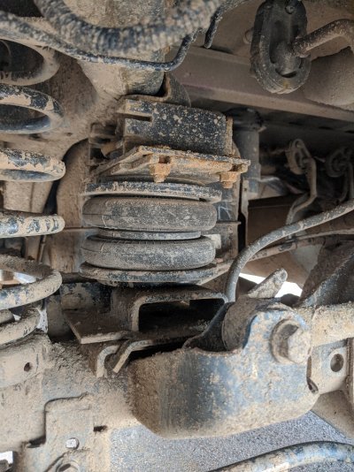

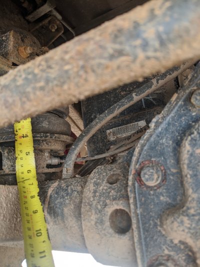

I got the air lift 5000 with the bolt-on kit and my Ram does not have enough clearance for the bags to work best. The bags needs 5.5" for optimum performance, it's at less then 4.5". The measurements are taking at the airbag plate itself. And since I have the Ultimate the Joyce-Bouncer is "activated" way to early. I do not want to raise the truck anymore then it is. Next buy will be the Blisten 5100 at the front to level out the truck.
I will go ahead and bring the welder in me out of retirement!! Lol. No but seriously I used to have my tickets.
Imma go ahead and refab the top portion of the Bag "bracket". Definitely gonna have to cut the original bump stop and fab something to get proper clearance.

Edit : the more I look at it the more it will by simple. Gonna need to cut and get the angle right and then weld a plate that match up the top plate of the bag for easy bolt on.
Come to think about it gonna have to find a way to put 5psi in the bag and see where that brings us with the wait of the truck right
