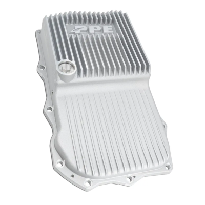

Do NOT keep engine running with no fluid in transmission.. That will destroy the fluid pump in the front of the xmission.
If it is a 2 wheel drive, disconnect the drive / tail shaft to prevent the transmission from spinning with no fluid flow and keep in "Park" when towing it.. If it's a 4x4, put the transfer case in neutral ..
Your owners manual should explain in detail on what to do.
PS: I would replace that transmission pan with an aluminum one, such as below. Stick aint going through it.
