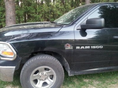

Some people have had issues with that composite material holding water against the metal causing rust on that area of the front fenders.

I believe its some kind of anti vibration or sound deadening. Its weird some people have the issue and others don't it may have to do with how well the factory or attached it, if it has voids water will seep between the metal.

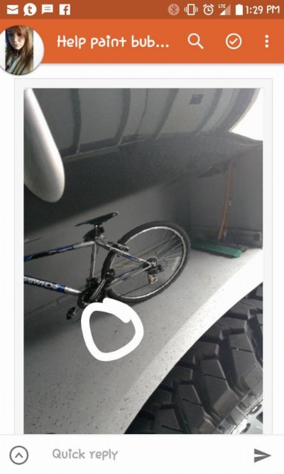

Hard to see with reflection. Look below bike tire reflection
