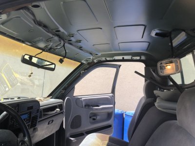

Hey everybody! Still pretty new here, but I recently inherited my Dad's 96 Ram 1500. It had been sitting for years and I want to start to restore it. I'm no mechanic but also not afraid to work on things myself.
Anyway, the headliner was a mess so I figured I'd start there. When I started removing the trim, the driver side pillar trim cracked while I was removing it. I thought I was being careful but I think it was just baked and brittle from the sun. Come to find out that that specific part is now discontinued!
Anyone have any advice on how I can go about this? Super glue? Anyone know of any 2nd hand shops that might have this specific part? Anyone else run into this problem when doing their headliner? Any help would be greatly appreciated. Thanks!

I guess I should have mentioned that I already replaced the headliner and am pleased with the results. I just now have the broken driver's side pillar frame to figure out.
