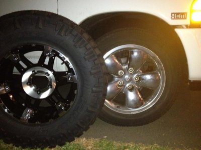

margarita
Nov 16, 2012
The new wheels n tires

I'm going to assume that they rub the fenders when turning. Is it just a slight rub? If so just a level might work. If you don't like the stuffed look the 4" lift you asked about would work

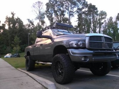

Or do a 6" rough country.... cheaper than a 4" and can add to it to make the lift bigger....
Sent from my VS920 4G
