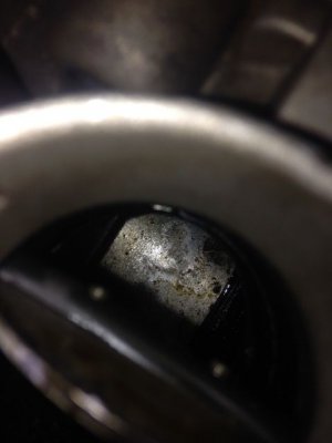

I have a 1998 truck that I changed the plenum gasket with the kit from Hughes engines. I was using 1 quart of oil/week or roughly 200 miles. I changed the gasket and am now consuming 1.5 quarts a DAY. I took a pic through the throttle body and can see oil. Did I make a mistake? Any help would be greatly appreciated.

It's possible the pan wasn't torqued correctly or the gasket is misaligned or torn.

I did use some silicone on the plenum gasket which Hughes engines does not recommend. Is any oil indicative of a plenum leak or is some normal? Also, in your opinion does this look like a significant leak?

Yeah I don't ever use RTV anymore. I stick to fiber and Fel-Pro gaskets. Using Silicone on any kind of rubber gasket tends to end in failure as the gasket doesn't get a good seal to the two mating surfaces. I think any oil in the intake should be considered a a significant leak. I'm not sure what would be cheaper, buying all the bolts needed separately and a new gasket or just buying another kit.
But hey.. lessons learned. You can't learn without making a few mistakes along the way.

Thanks for the input. I guess I will tear it apart again and be more careful this time.
