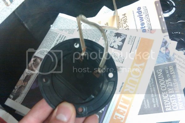

ok just did some tests.
tested the fused in the engine. its fine not blown.
then wired another speaker (fromm my boom box lol) to the amp and it played. so the amp is good and is transfering power.
then we ran that speaker to the wires in the box and that worked. so the sub is getting power....
i think the problem is the wires from the terminal leading to the sub...

yea i was right. the + wire on the terminal came off... had to solder it together again.
I got my boom boom back!! :D thanks for the help guys!!
