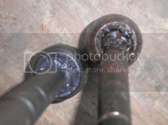

I was pulling into a parking lot and heard a clunk and noticed the drivers side wheel wont turn. I had to have it towed home. I found what i think is the tie rod looks like it unscrewed from the the steering rack.(not sure if those are the right parts) So my question is what do i need to do. Do i have to replace it if so how much and what brand? Is there a heavier duty one? Can i just screw it back in for temparary? Is this something i can do it doesnt look like there is to much to it. Will i need an alignment after.

From my looks, all that has happened is the inner tie rod has seperated from the rack and pinnion. This could be as simple as screwing it back on, or you may need to replace something on the rack. Thats crazy that this happened, be lucky you were not going 60mph in a turn. I would need a closer picture of where the actual seperation has occurred.
And Yes! You must get a new alignment, I would assume this made your alignment already crap. Moog sells great tie rod replacements, check it out at rockauto.com

thats your rack busted, I believe....they run about $200...I think that piece is pressed into the rack there...I may be wrong though

so i need the whole assembly or can i get just the inner tie rod. the threads look fine.

If I remember correctly those thread into the socket. My '04 was lifted and had these spacer things to go in between that spot. The tie rod backed out and the last few threads were damaged. I got a new tie rod and put it in. (Took the spacers out)

thanks already got it done just went with a cheap autozone inner for a quick fix. i have to replace the whole rack assembly. When i was taking it apart i found that it was leaking. I thought it was from when i did my powersteering pump but its not. But the inner was simple to replace no special tools needed. just take of the bolt for the outer and tap it with a hammer and it came right out. Didnt even have to take the tire off or put it on a jack.

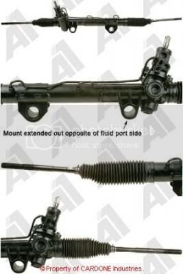

thats a good thing i saw some on rockauto.com but do i need a special one since im lifted. do they make a heavy duty one?
adamwilkes14
Oct 20, 2010
2,413
12
Not that I know of....how much are you lifted? Are you running stock upper control arms?
