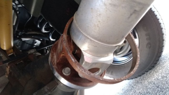

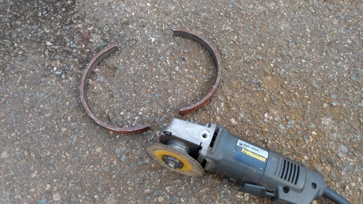

2021 RAM 2500, 6.4L.....I have the worst luck when road tripping. Getting ready to leave for Florida tomorrow. 2400 miles round trip. ....Driving down the road to run an errand, a truck in front of me drops a block of wood. It bounces up under my truck and destroys the driveshafts harmonic balancer! I tied the remaining ring back with a piece of wire and went to the dealer. The whole drive shaft has to be replaced and Lord know how long that will take to get one. With the ring tied back, I took the truck out on the highway and I'm not feeling any vibration. I'm going to cut the ring off in any event. Can't even drive it around town like this.
SHOULD I STAY OR SHOULD I GO?

I just took it out again on the highway. There is no vibration. I don't believe this has anything to do with balance. I believe it is to remove any small vibrations that might remain after the Dshaft is balanced.

BTW, as you can see in the pictures, this dampner is not on the drive shaft. It is mounted on the rear of the universal joint. On the differential.
