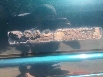

I've recently removed the RAM 1500 badges as well as the V8 badges, they left a thick, old black adhesive on the truck and I'm using GOOF OFF to remove the adhesive... it removed the "Sport" sticker residue fine but this stuff is thick and I'm not sure if it'll work. IMG_4386.JPG

use a heat gun to warm that stuff up. If you don't have access to one then use a hair dryer on high and take your time using it to warm up the glue. It should melt it enough to pull it off, though it will take time.

So no adhesive remover on that? I used a heat gun on the sport stickers and they came off easily, these not so much.

I can't think of anything to remove it with. I work at a shop that upfits police vehicles. We outsource our stickering/decals to another company. I don't think I've ever seen them use chemicals but that doesn't mean they don't. I wonder why the heat gun didn't do the trick. :word:
Edit: You might try this guy's trick. https://www.youtube.com/watch?v=BM5xbv49uok

I'll give it another go with adhesive remover tomorrow, if that doesn't work I'll use the heat gun again. Other then that it's like really hard, old glue from 1996 lol

Clean the area good and try an eraser wheel

Try WD-40. Sounds weird but spray it and let it sit for a couple minutes and it will come right off

How? eraser wheels don't ruin paint - all you have to do is keep them moving. I have used the same one on three different trucks with no issues

It looks like it either nicked the clear coat or scratched it, here's a photo of the wheel btw 9cb8dd0b1c7be7e192c71ef199918d64.jpg

It cant nic the clear coat or paint. Its much softer than either. If there was debris in the leftover glue then that could've caused the damage when the eraser wheel hit it.
I forgot to mention, keep the drill slow. I mean slow, half speed is too much. You're not trying to burn the glue off, the wheel needs to grab the glue peel it away then flake away from the wheel as it comes around.
The textured wheels are a bit easier to use as they have the eraser wheel equivalent of flutes on drill bits for chip clearance.
If it chipped something, just keep going and get something to touch it up afterwards. Using anything that will dissolve the glue is very likely eat partway or all the way through the clear coat and paint. In the long run, most solvents will cause the area to 'cloud' over time unless you either keep it waxed or hit it with more clear coat.
When you use the wheel i've found that going as slow as you can while moving it back and forth a bit while applying light to moderate pressure. It will take time, its nothing fast but its faster than most other things. It took me 5 minutes to get all the glue off from each badge on my truck when I was re-gluing them on. I managed about a foot a minute on some pinstriping on an old chevy van. (I say old but it was the same year as my truck :roflsquared: )

Have you tried soaking with WD40 or penetrating oil, spray it to soak the area and leave it set for a while. Should loosen glue. I've used this method on decals and stickers it works well, then use plastic scrapper to remove glue.

I use a blow dryer, a brand new razor blade, carb or brake cleaner and sometimes my finger nail. I have yet to have any paint damage.
