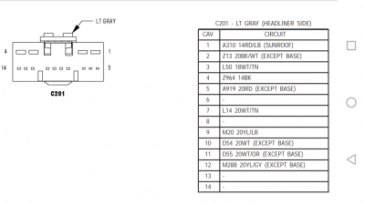

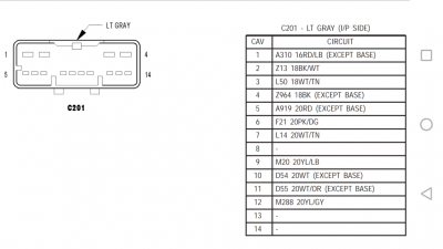

I think this is the one you are looking for. It's the C201 Instrument Panel Side connector and the C201 Headliner connector. Screenshot_20191004-205243.png Screenshot_20191004-205155.png

Weird that looks like the right plug but I have three different purple wires on one side this doesn’t show them is this for 2007 model? Thanks
