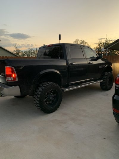

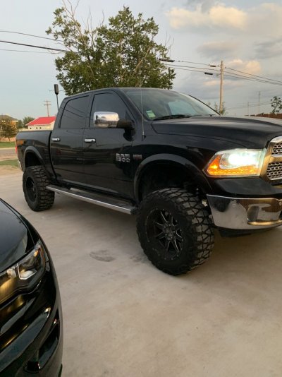

Weather finally cleared up and was able to get pictures. As it sits it’s 1” lower in front than in rear

Thanks! I’m in the process of adding a 2” motofab leveling kit up front, driver side is done. Bout to start on passenger side. CV and top ball joint angles don’t look bad at all. If it does end up nose high I can air up the rear airlift bags or just remove the leveling kit.
