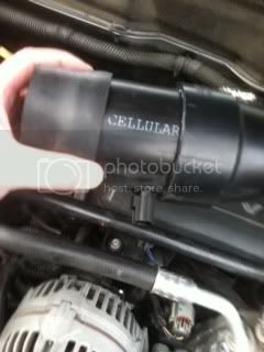

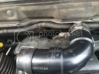

Ok I've been on the quest for the low budget mods and performance upgrades. So far I've acquired the used SC 3815 ($168), dropped in a high flow air filter ($30) and swapped the Hemi Hat for less restrictive tubing using a few clamps, ABS pipe, and grommet for about $30. The result was this:
First I mocked up and dry fit pieces
Then I drilled a hole and placed grommet for the IAT
IAT remains in stock location behind alternator
And here is the streamlined intake
