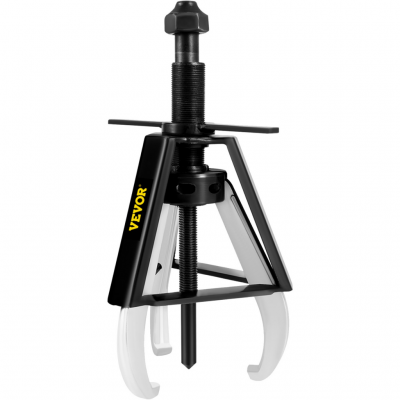

My first thought is, where did you get the new pump, and does it have any kind of warranty. No way a pulley should ever break, I have never seen that before. That said, any three jaw gear puller should be able to remove that quite easily.

Power steering pump pulleys have there own special pulley. NEVER use a 3 jaw puller.
The puller is a clamshell design and are available at Autozone to use for free or purchase the kit. The clamshell grips the ring at the end of the pulley. To install, they get pushed on flush either with the proper tool or by using a bolt, washer, and a nut to press it on.
On edit I included a picture of the 2 different styles.
Normally i would agree with u but if you look at the picture i don't think there is enough pulley left to do that. Good part is, OP says it is under warranty from Rock Auto. Just swap pumps, no need to figure out how to get the pulley off. :)

Fyi. The pullers grab that ring at the end of the shaft. You can see it if you zoom in. A jaw puller can't grab it.
I just saw his latest post. The new pump hopefully comes with the pulley installed. I've bought them either way, with or without the pulley.
You are spot on, when i zoomed in there is enough of the collar to use a standard puller. WAY better way of getting it off.
OP sorry it was only the pulley that was covered. That is more work.

The pulley puller set I rented from Oreily does not work on a 2010 2500 5.7. The "clam shell" is too big for the outer ring to fit. Both sides of the clam shell are touching the shaft of the pulley yet the outer ring will not go on. Need a different kit. I tried holding the clam shells on with a pair of curved jaw channel locks and using my impact...No Go...maybe I will try a pipe wrench.
Found this site that sells Pullers for Dodge Ram https://www.carid.com/2010-dodge-ram-pulley-pullers/
