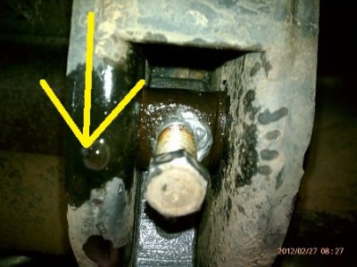

Ok so my torsion bar keys showed up and I had my guy install them this morning but I have a problem. When you start cranking them up the bolt starts to slide out towards the side see the pic below. Is this typical of dodges? I work at a GM dealership so my guys aren't to fimilar with dodges but he said he'd never seen this happen on a GM truck when he put keys on...
(the arrows show which direction the bolts are sliding towards)

What would happen if you cranked up the stock keys? I've done two Rams and one Chevy Z71 and the process was identical and I didn't notice any "sliding" of the bolt on any of them. BUT, I've always cranked the stock keys, never used a leveling key, never saw why you would need one myself.
I'm thinking it's the angle the bolt comes into contact with the key at, in other words it's the leveling key that's causing it...

I have noticed that when the front end was unloaded fully on a lift. Whats up with the fresh weld on the keeper?
It's anti-seize not a weld...
My guy does have the torsion bar tool and is a professional tech at a dealership, He's afraid if we keep tightening the bolt it will pop out under load. I've been driving the truck all week as is and haven't have any problem but I want to crank the bars and get more lift. So far the front end has only raised 1" and is a ton softer than with factory keys. I'd like to get another 2" out of the keys...

I still say there is something with those leveling keys. What brand are they? Done the crank on stock keys before more than once, got 2" and had no problems...

No not Typical, Did the bolt and camber piece fall out on the floor (was the bolt totally removed). Looks to me if you flip it around so the off center hole will be pointed outboard cutting into the key/rather than skimming off.
I thought the bolt was threaded straight through the beveled piece but I could be wrong. I never had a problem doing mine other than a big hole in my wallet for the pro ball joint service kit I had to buy.
Check if the other side is canted outward, if so my theory is correct and all is well if not and it is threaded straight then I would say its a rare defect that went unnoticed by the technician prior to initial dis-assembly and happened to be outboard. If not order a new bevel piece or worst case have one made from some round stock.
Did you ever figure out what the problem was because I am having the same exact problem right now I took my old keys out installed new keys and the same thing is happening
