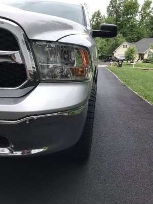

87F1232E-37A3-49FA-BD1B-D3F4B013C9AE.jpeg Its multi-answer solution...wheels and tires. Are you sticking with 275/60/20 or going with a wider tire? Also, do you have flares? I kept my tires to 33.2” (305/55/20) but now the tire is 12.5” wide versus the stock (10.8”??)
My wheels are Moto’s 987’s. 20x9, +18 (stock) offset. No flares and they poke out maybe 1/2” as you see in above pic. If you have flares, I would say a zero offset minimum to a -12 max on 20x9. It all depends on how you answer the tire size question. That is going to be the HUGE determining factor on which wheel would look the best.

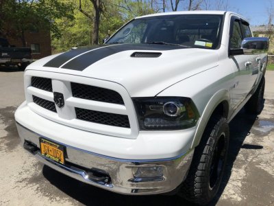

@golfinds Okay so with looking at my set up you can judge how far out a 12.5” will sit on your rims. Mine is stock offset 20x9 w/ 12.5” wide tire. A zero offset will poke out 18mm further and a -12mm offset will be 30mm. -24offset=36mm etc etc.
hope this helps and post pics when done,

Much appreciated. I think your set up is what I am after. I’m a little too old for it to look like a teenagers truck but i do want some style. Lol

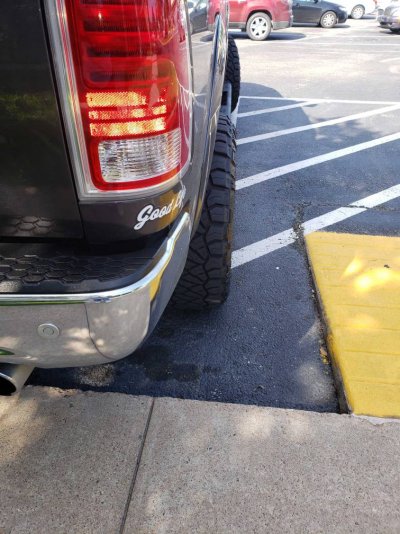

20x10. -24 offset. 33”toyo rt. Belstein on all 4 corners. Front leveled at the 2” position
