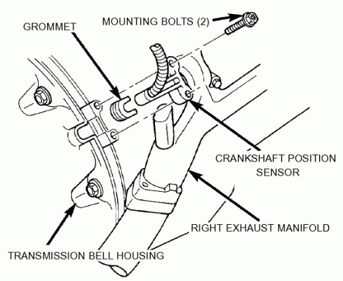

2001 dodge ram 1500 5.2 liter engine needs crankshaft position sensor where is it located at

Couple ways to do it too. Can go underneath and reach up (Mercs way), pull the airbox and reach over while laying on the engine (my way), or pull the fender well and reach through

It's a pita reagrdless haha I'd say easiest is from the top, if you have longer arms.

Yep from under the truck.

I prefer going over the top passenger side but then again I'm a younger guy, only 5ft 10 with not short but not long arms, and stock height truck. Merc and Bbartow can pretty much kneel under theirs:roflsquared:
