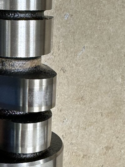

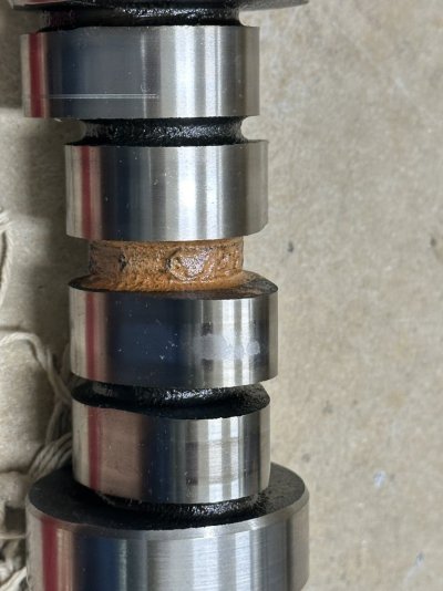

So I was planning on a preemptive cam/lifter swap on my 2014 1500 with 54,000 miles to avoid the shrapnel in the engine. Last oil change I cut open the filter and found metal flakes: no longer preemptive.
Every lifter was still in perfect shape: rollers have no wear, roll perfectly, have no vertical play, yet the cam is losing metal for no reason.
Very odd and annoying.

To be honest, that is a very light scuffing and I don't know if that would even register at this point as a valve lift issue. But super lucky you caught this and I second the request to send the oil to Blackstone, would love to know the wear metals.

I would agree with OP.......there is flaking/pitting on the lobe.
It's shiny around the same area where the roller is in contact with the lobe.
Probably Chinese iron alloy.
We have machined some junk metal from China before & still do.
Yes, you can see the pitting on the second lobe from the bottom in both pictures. Those are different lobes. More lobes looked like that, but to a lesser degree. It is like the hardened layer was only half a hair thick and started flaking off.
Half a hair thickness would be about .002
LoL........
You stay in the upper RPMs much?
Could be roller lifters skidding over lobes stressing them from weak valve springs but if that was the case should be roller wear signs on lifter

Need to put that cam on a hardness tester to see if indeed the case hardening was deep enough.
Hardness about .06 deep is the norm.
Flaking more than likely caused by stress.
