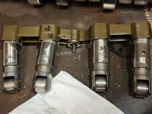

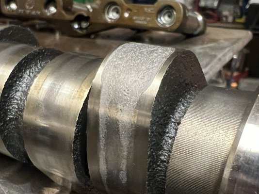

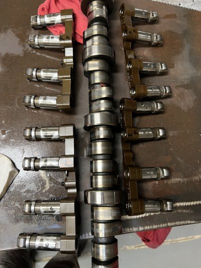

Cam and lifters show wear/marring, but not to the extent that I have seen on other posts, nor to the extent that I would consider to make that loud of a tick. I found the cam measured .030 max end play before removal (supposed to be .001-.003), but all bearings and surfaces check good (I don't understand the reason for such large endplay). One of the cam lobes (the worst being shown) is slightly grooved. A few of the rollers show marring, but all rotate and appear to have no unusual play. I am replacing the cam and lifters, but my main concern is that after reassembly the tick will still be present (again this is not an injector tick, this can be heard 20 yards away). What am I missing, other than hands on or visual experience?

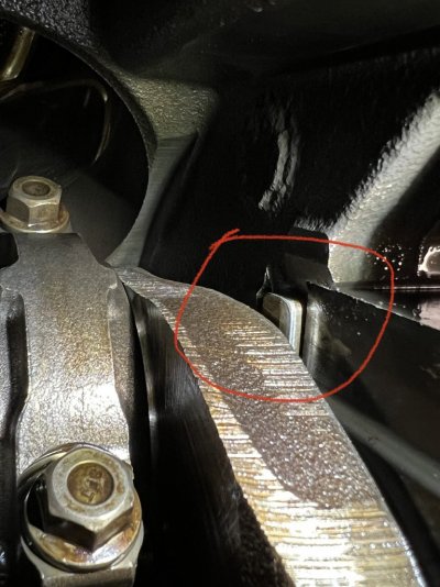

On further inspectionCrank: I believe this tab (circled in red) on the #3 main, to be the thrust bearing. I can wiggle it up/down (head to pan) about 1/32nd of an inch, moves freely enough to make a slight tick sound. It has no fwd/aft movement. Wanted to know if I have correctly identified this part, and should it be moving/moveable?

I wanted to follow up on this post as I was worried about the “tick” remaining after reassembly; my inspection had found minor wear on the cam lobes and no significant lifter/roller issues.
In summary… I replaced the cam & lifters (both showed marring and one lobe with minor grooving (0.011), I say minor based on what I have seen in other posts. Anyways… I also found that 3 of the intake and 2 exhaust pushrods were extremely worn, the worst being 0.128 inch shorter than spec. My assumption is that this “tick” was initiated by poor lubrication between the rocker arm and pushrod ends, leading to excess lash between rocker arm/pushrod/lifter, with the lash ultimately transferring between the cam lobes and lifter rollers (resulting in cam marring). I must have caught it in time, before a roller eventually failed and ground the cam to the extremes we see in other posts.
Bottom line, if you have a “tick” (and I mean a 20yrd away audible tick), but you don’t find anything significant in the cam/lifter inspection, DON’T OVERLOOK pushrod condition and length before reassembly. I just wanted to tell the rest of this story, as I never found anything in these other “tick” posts that key in on pushrod inspections (seems limited to cam/lifter replacement only).
