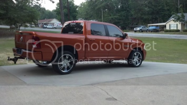

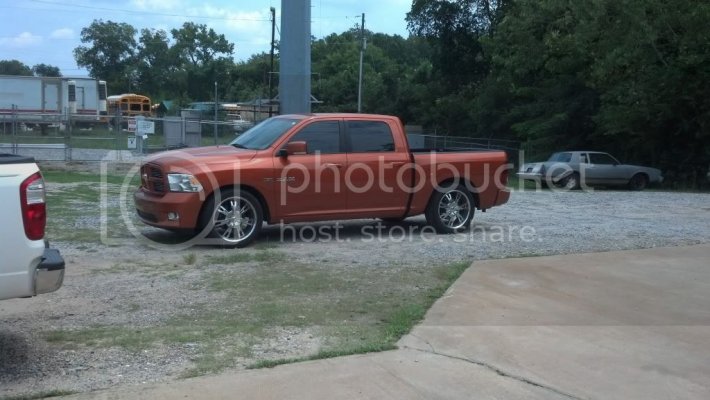

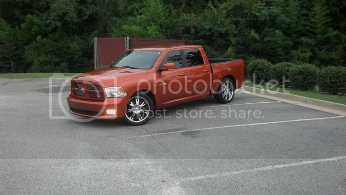

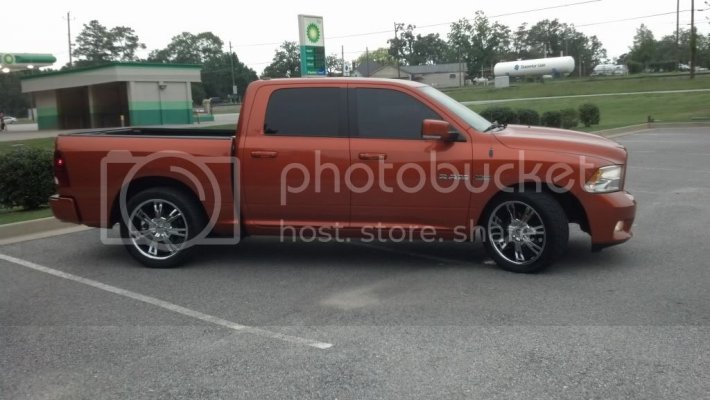

Belltech 2/4 kit with street performance shocks. Im gonna need to get either the trackbar relocation bracket or the adjustable bar. The shift it barely noticeable but its eatin at me cuz it mine.... The wheels are 22x9.5 with +18 offset the tires are 305/40/22. No rub so far, ride is good on the backroads havent hit the highway yet though. With my 7x18 enclosed trailer hooked up and 20lbs in the firestone helper bags it sags about 1 1/2 in. But i didnt tow it just hooked up to it so it may actually bounce a little more Ill find out about that next week when i cut grass. The parking lot in the pics had a little slope to it so it looks a little odd in the pictures.
