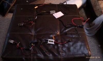

ok, let me take that pic you have and label it up! Gotcha here man.
0212353
Vendor
Jun 29, 2010
26,460
2,029
Florissant, MO
2x 5.7L & 6.2L
ok, try this Nick:
all bulbs come with those extra connectors on them - they are used on some vehicles, not in the Ram though.
Let me know if you have any issues - I'm on IM all night!

so was that set up correct?

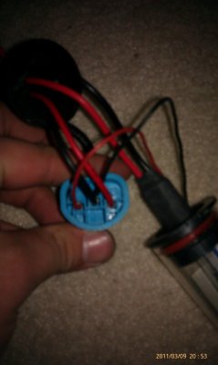

and on the OEM connector i did not see anywhere where it could plug in.
there was a blue adapter that i thought the 3 stray wires off of the lights plugged in.
and the extra connector is the part that has the snap on?
i have the kit right next to me im gonna try and set it up again and ill take a pic.
thanks Jeremy!
05singlecabHEMI
05singlecabHEMI
Jan 26, 2011
2,692
99
Lilburn,GA
2005
ok this is the set up i got from the picture you put up.
that Blue part goes into where the old light was plugged into and the female wire near the relay, the short wire, im not to sure where that goes.
and for the blue adapter is that the wire set up?
thanks!
