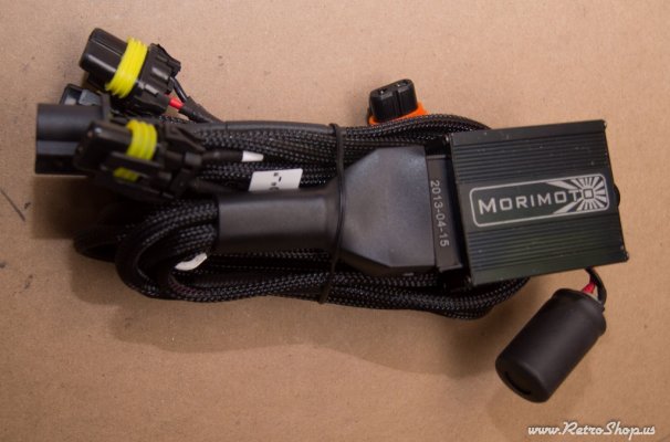

The bixenon ones we do use a control box rather than the relays. (for now!)

Nice harness, can u get a picture of the Dual harness? The bi-xenon one.
Thanks. I'm wanting to do the heads/fogs here soon.
Does your fog kit come with a harness as well? Is it needed for that?
I'd probably be wanting to run 55w heads/35w fogs, so 8000k and 6000k should match?

Fogs, we do use a harness on as well.
For color, we don't do 8K....period. 6K is the highest we offer.
