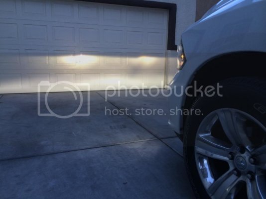

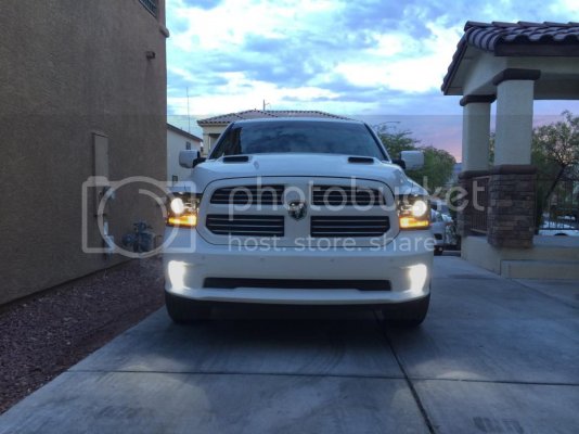

here is my 14' Sport with 5K HID headlights and 6K fogs, ordered from JJ with the canbus adapters
