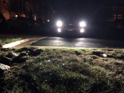

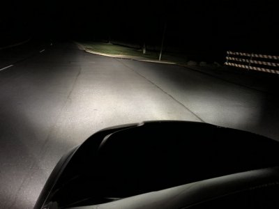

Once fixed.. the results are amazing! Pics below.
These are the 35W 6000k bulbs
Note, I am also running Putco Nitro Lux Pros in my fogs.
Just the headlights, no fogs
With the fogs

Here are the results with the 55W 6000k. Insane! Whole new driving experience at night!
No fog lights
With fog lights
No fog lights
With fog lights
