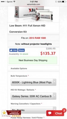

Well from i see from the pic of your order you didnt get the warning cancelors and capacitors and they are needed
I was told i did not need them. Besides it ended up being a bad ballast they got one on its way now.
