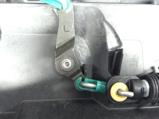

I apologize if this is the wrong place to post this. However i would appreciate some help. My left RamBox won't unlock or lock when i press the button on the keyfob and i have to use the manual key

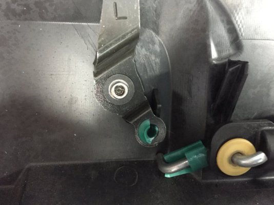

The manual lock and electronic lock are not connected, they are completely independent. Most likely the little plastic clip that hold the rod to the lock mechanism broke. Easy fix if you can work a screw driver and pair of needlenose pliers.

Here’s what is broke
