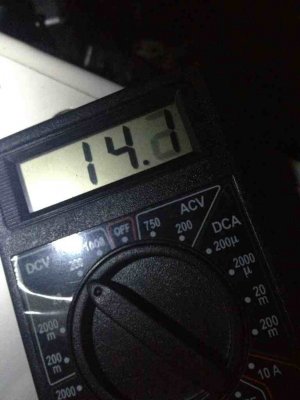

Not knowing is gonna keep me up tonight, give me 15 mins and ill have results from the plug for you guys

The low beam voltage dropped to 3.5v when I switched to high beams, is that normal?

It shouldn't be that high. Should be +/- .5 V from 12V. So I'm not sure whats going on there. Did you try it with the headlight plugged in?

Start with the headlight plugged in. And we'll go from there. Hopefully it'll turn out to be something simple.
And don't worry about the Voltage. For not being plugged into anything and with the alternator churning its really not that high. Since you're basically just reading battery volts.

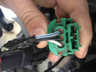

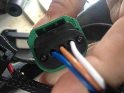

Either I'm not getting a reading due to insulation around the plug wires in the plug, or there is no reading at all.
You can see the insulation around the wire
I don't think there is any on this plug, I don't think I can get my prob far enough in there to read anything.
Anywhere else I can test?
