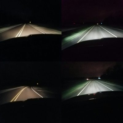

When ordering I highly recommend go 55watt. I went 35 and it's a beautiful white but it's actually harder to drive with than the mediocre stock lighting. This is the 5k from retro shop. Really wish I had gone 55watt

Honestly I think it's just the color. I'm so used to the BRIGHT white of a 55 watt kit that this somewhat blue hue makes me strain a bit. I mean obviously a 4500k or yellowish is the most appealing performance wise but not aesthetically

A 6500K HID kit is a LOT better than a 4500.
My thinking is you need to change bulbs.
You can always change out the ballasts to 55W as well if you want.

6500 35W is WAY to blue for my liking. That's a hard pass

All a 55w ballast provides is 25-30% more intensity in the light output. I'm not sure what your reasoning is for wanting them? For a color difference? A 55w ballast will reduce the lifespan of your HID bulb. Also it washes out the color of the HID bulb (if that bulb is not specially made for 55w ballasts) such as make a 5500k bulb look closer to a 4500-5000k

So I went back to the same road I took my original before photos. The darker asphalt makes the light much whiter an enjoyable. On a light colored road it's a slight green tinge

Look brighter than mine but I have my passenger side not as bright for some reason. Haven't had time to figure it oit
