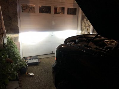

+ 1 for Headlight Revolution HIDs.
2017 Ram Sport with projectors.
The lighting brand HR uses is GTR Lighting. I don’t have good enough things to say about Headlight Revolution... they have been beyond awesome in customer service, callbacks, YouTube videos on installs, etc. I went back and forth on the kind of lights I wanted, finally settled on GTR HIDs using 55W ballast and 6000k bulbs (these are almost ice crystal diamond white with a very slight bluish tint on the edges.) The 55W ballasts make them almost identical to OEM HIDs you see on fancy Audi’s and BMW. Have had zero electrical problems and/or problems with projector bowl melting, etc. Headlight Revolution has also mentioned they have not had any problems with the 55W from any users, I made sure to double check because at first I had heard otherwise.
These HID lights come with a “Smart ballast”, without harnesses and the whole electrical mess some other companies have. These thing are super slim - they come with really strong adhesive that keep them solidly anchored on the truck frame. Just attach them, plug them in and you’re good to go. No need for Alfa OBD and no need to drill into the frame.
Yes you still need to drill a hole in the dust caps to run the wires through but it was super easy and the lights come with a rubber grommet that absolutely seals that hole like new. HR has several videos on YouTube on how to drill those holes using a special conical shaped drill bit I found at Home Depot.
For the fog lights I kept my original Putco Nitro Lux 6000k LEDs.
With both on at night the lighting is beyond ridiculous. Absolute6 fabulous. Pics below.
good luck!
Headlights only, no fogs (below)
With fogs (below)
Without the fogs (below)
With fogs (below)
