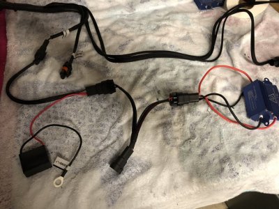

I finally got everything for my HID install and want to make sure I wore it up right the first time.
2017 1500
2013-2014 Tyco Projectors
Morimoto 15+ Mopar harness
Adapters for the headlights
Box also came with 9006 extensions. I reckon I can use these if needed to get the resistors to a safe mounting place.
So, I’ve read a post from one of the vendors with instructions, but I want to make sure I understand everything before I screw something up electrically with my truck.
So, on the harness, I know the ballasts go to the ballasts, that’s self explanatory, so is the battery and ground.
There is one that has a splitter with one end attaching to OEM input and the other attached to a pair of resistors. I believe this goes to the drivers side connector coming out of the gromet that is connected to the OEM bulb connector.
That is the only OEM input wire on the harness. If I read the instructions right, the connector on the passenger side that comes off the OEM bulb connector just gets hooked to the resistors that are standalone?
So no additional input or connections for the passenger side?
Anything else I need to know? I know the resistors need to be mounted to metal. I’ve got steel hose clamps and self tapping screws depending on what I find to mount to. Thanks in advance.

Your on the right track. Make sure when grounding the capacitor you have Bare metal to attach the ground loop. You should be able to print off the instruction sheet which provides a line drawing for routing Harness and connections.
Thank you for actually answering the question. Very much appreciated.

Got them in and working. Just need to aim them when it gets dark.

Install was a bit different than what I did on my previous ‘13 F150 when I added the OEM projectors and HIDs, but it wasn’t as bad as it seemed when looking at the harness.

I have the same kit being delivered today, any tips after your install?...did you drill the cover and use the rubber grommet?
The connector on the harness for the bulbs won’t fit through the 7/8” hole. You will have to make some relief cuts across from each other.
I sealed the gromet to the cover with some black silicone.
