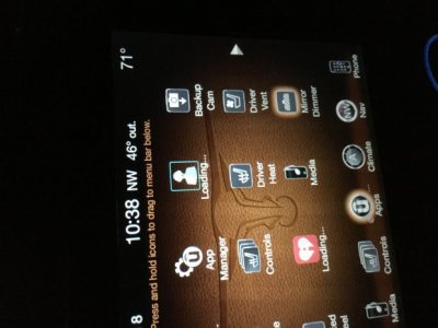

farecho
Mar 30, 2016
11
Lakes Region - New Hampshire
Just a APP....press it and back up camera comes on for about 10 seconds....enough time to check your load. Maybe a firmware update would do it?

jadocs
Mar 23, 2014
689
140
6.7
Yeah I think it's a model year thing. I do not have that option (or the option for wallpapers) on my 2014 8.4an.

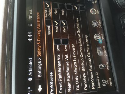

On my 13 Ram, when you put it in reverse the mirrors tilted down so you could see the ground backing up. On my 16 Sports I can't find the function to program this. I was told that in 16 the options was not available. Anyone have a 16 that the mirrors tilt down in reverse?

farecho
Mar 30, 2016
11
Jay
Go to "Controls", then "Settings", then "Safety & Driving Assistance"....see option
Pull Ya
Jan 16, 2012
16,064
23,921
Cedar Creek, Tx
Tried that--it's not listed as an option

Maybe I got the cheapo model---LOL
roastpuff
Sep 24, 2015
207
133
Jay
Laramie and above only. Sport doesn't have it.
