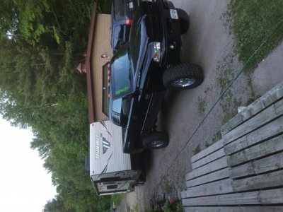

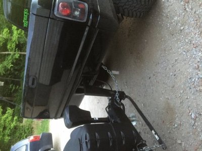

U will be good. There rated 500 tounge and 5000 pounds. I have one and pull 7000 pound travel trailer with weight distribution hitch
