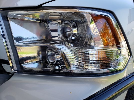

We put HID Bi-Xenon Projectors in quads, both the high and low slots. Had to do a bit of trimming and a lot of aligning.

D2S 4.0 and Profile Hi-Lens:

I did install the morimoto HB led highbeam projectors. I installed them in a set of alpharex 2019 style headlights so I didn't have to worry about fitment. Mounting was more of a challenge.
