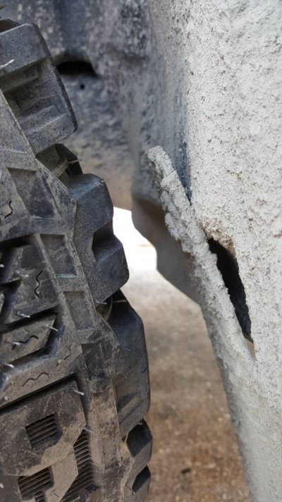

Picture of tire clearance with my 1.5 spacers installed on 285 70 17s . Should only have minor trimming to do to fit some 35s. c6ad7e6d83a1d0563f469eee87228578.jpg999f308cf113d83d08267387b0a42155.jpg179c6e7192c174108c0a764a148d3227.jpg

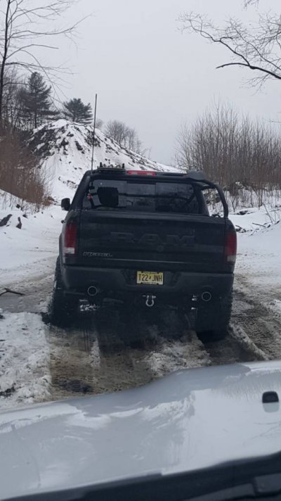

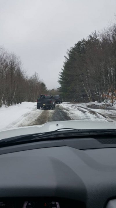

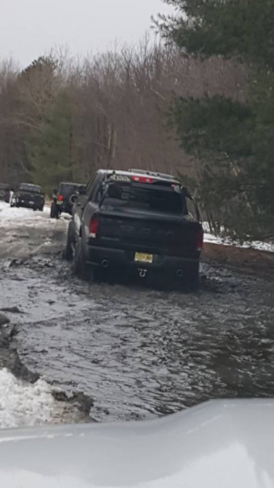

Was nearly impossible to shoot quality pics with a caravan of about 20 rigs. Plus it was so wet and cold I wasn't keen on getting out. Next trail ride in April. 93c38778a66f7cc61d236b1806fb1f2a.jpg1f3cb93c15fa0eae24478f5b43fd5a90.jpg9cf94a6ceca2547be3844603ebd9960c.jpg5b331a374901bbb439ff350d93327af0.jpg5ad2f9a956aedc263dd38b0ce3eeddfb.jpgd0ccfd83cd893b8d59da5cad53b17c2e.jpg
