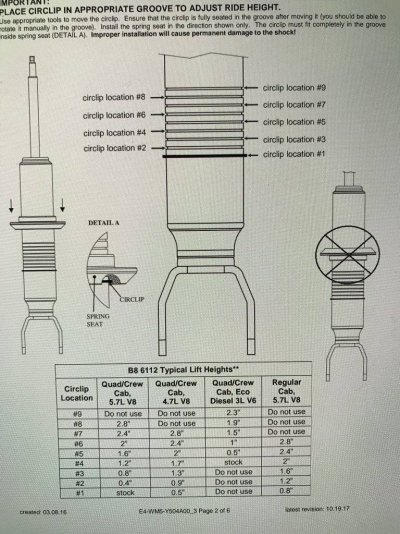

6112s set to 2.3" front
Bilstein 36-286539 rear coils 1" rear lift
Bilstein 5100 0-1" lift shocks.
Oem UCAs for now
285/70/17s oem wheels
