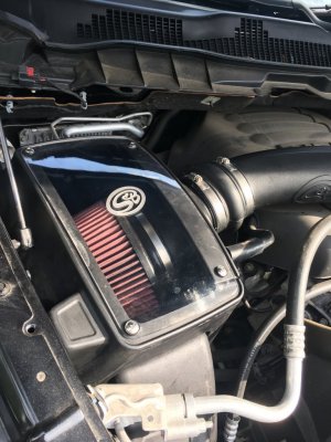

Heucobob
Jun 6, 2017
100
96
This is my S&b so far the throttle response is better but will see when it’s actually cold out to see if we have better performance it been 90s since I installed it so no real cold air yet lol
