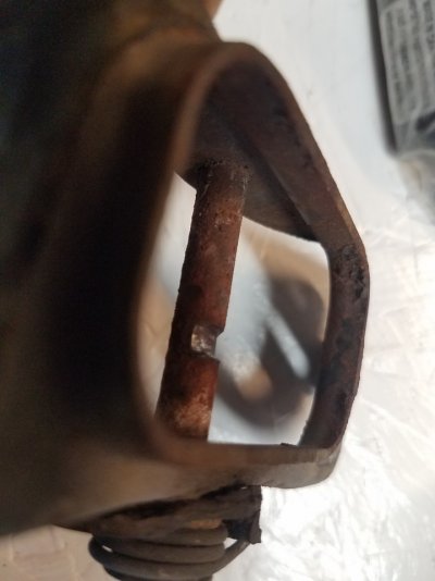

My upper latch bar was worm about a 1/4 of the way through and was causing the hood to bounce around some when driving. That's why I went ahead and replaced it. The lower was also showing some wear.
This was the old upper latch.
Geez man that looks like someone got excited with an angle grinder.
