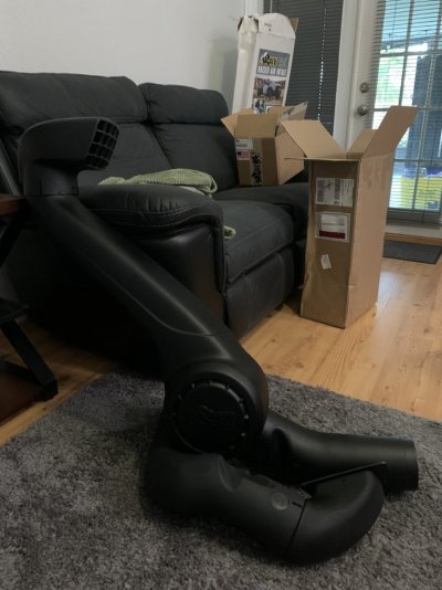

Or buying a snorkel for forced induction based on mph. Lmao. I’m just partially kidding. .1 psi at 80mph. Or so the online calculator says.
Edit: ok found another website that states roughly 1psi per 100mph depending on scoop size and engine airflow cfm

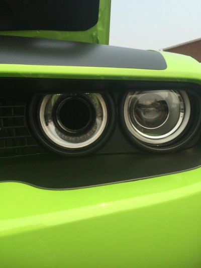

I’m surprised no ones mentioned real ram air mods.
For example some Hellcats remove a head lamp and replace it with duct work for ram air effect.
With some production vehicles manufacturers use a front fender panel assembly in line with the air intake and slightly widen it’s forward gap.
In this manner it’s purpose as assembled and engineered is to allow more air to pass through towards the intake filter and airbox.
Track style intakes. There’s a few guys running them. I would but being my truck is for off-road and not a dedicated race rig I don’t want to risk dust/water ingestion from the intake being low in the bumper or in the grill

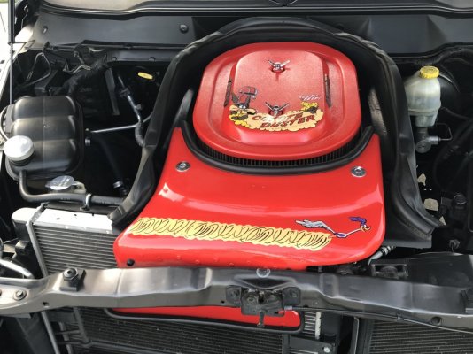

Tray Burge
Jul 30, 2015
2,732
3,384
On the porch
2003
Just a heads up,it's not really a "Ram Air " per say,the hood vents are to close to the hoods surface to provide any Ram air effect. A scoop has to be a mininium of 2" above the hood to get past the dead air space.
Not to mention you have to be going like mach1 before you actually get a "ram effect."
But, fresh is always good too. lol

You did a nice job on your scoop Tray,only downside to doing something similiar on a 4th Gen is the scoop would severely restrict airflow to the transmission cooler.The transmission cooler on the 4th Gens is the top part of the A/C condensor
Tray Burge
Jul 30, 2015
2,732
3,384
On the porch
2003
Yeah, the older ones are mounted in a different location as you can see here, but I did have to relocate my radiator overflow bottle to the left side.

let’s see what my truck reads for manifold pressure before and after my snorkel. Also hoping to see intake temps drop. I know highway driving my intake temps should be the same as ambient air. May have to get my snorkel wrapped or spray paint it silver. If I wrap it I’ll get it done in chrome to be reflective probably. Spray painting may be easier and cheaper up front since the black may absorb more heat. Thoughts on that?
Jan 17, 2016
23,721
54,483
14 Sport
It's tough to get your IAT's to ambient air temp Khris,the IAT sensor is past the air filter,and under the hood. If you get your IAT's to with-in 4 degrees of ambient,your doing very good. Are you installing a pressure sensor in the intake tube ,as i'm curious on whether you show a positive pressure at 60 mph or higher

If I ever get around to installing my plx wideband they have the option to add in an air pressure sensor to their kit that I may end up purchasing. I was planning on logging manifold pressure from the map before and after install to see if it changes. A higher vacuum would lead me to believe that the snorkel is more of a restriction to airflow. The same or lower would make me think positive pressure or no change.
