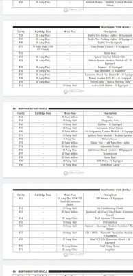

Check fuses on your truck. There should be a dedicated left turn fuse.
F53 yellow 20amp.
