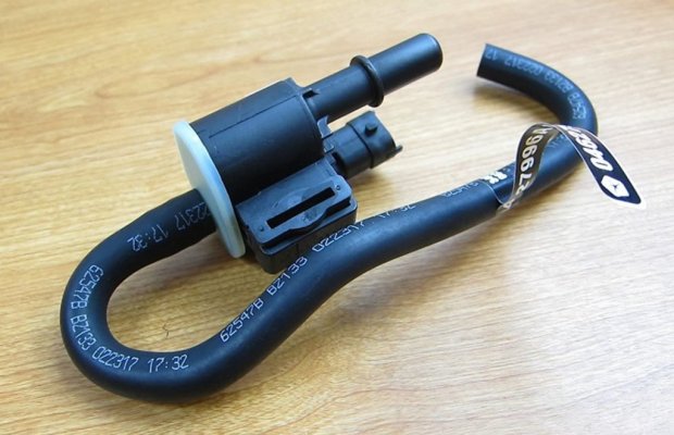

Looks like an Evap emission hose.
Theres a few on the canister on the frame near the front of the tank.
Also check under the hood. Specifically the hose from the fuel vapor purge valve. That hose might be missing or the hose you found is an old one if you ever had your purge valve replaced in the past because they sometimes come with new hose like the one below.
