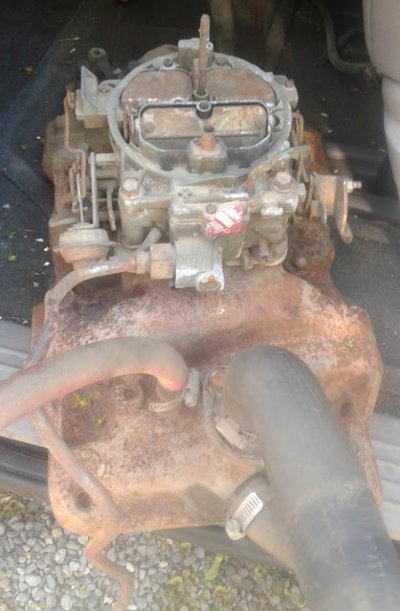

heck i picked up a stock 4bbl intake and carb last year for free. i didn't need it but i wasn't going to turn it down.
