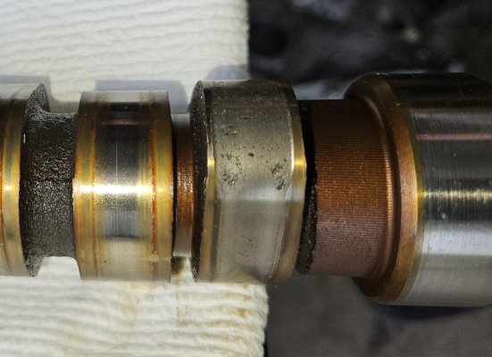

I changed my oil according to OCI on the EVIC, made it to from 28,684 miles to 201,192 miles, with ~8.5% idle time
Then there's the idea of just the occasional bad cam or bad lifters. This is kind of where I'm at. All it takes is a batch of needle bearings that aren't up to snuff and you're going to get a ground down lobe eventually.
Note the 3.6L Pentastar eats cams on occasion as well, likely for different reasons, so it's possible just Chrysler hated you and wanted to punish you with cam failure for buying their products.
I also subscribe to the theory the cam/lifter issues are due to substandard / aka cheaper parts,i also sort of think the valve springs are a bit on the weak side and allow the lifter to bounce at times. When Hoover redesigned the hemi for VVT he spec'd a billet cam,if the bean counters hadn't killed that idea due to cost,there'd be very few cam issues.
He knew the redesigned VVT Hemi would have cam failures,otherwise he wouldn't have spec'd a billet cam for them.

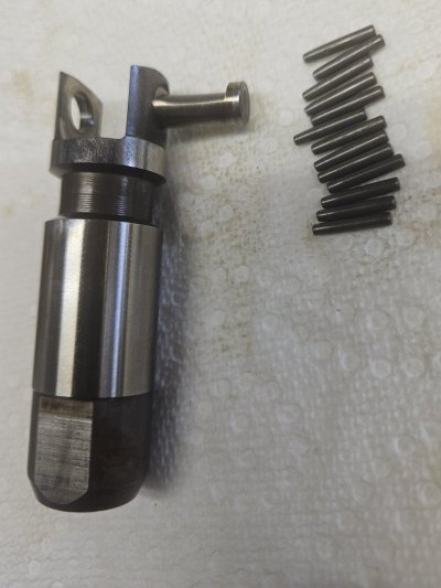

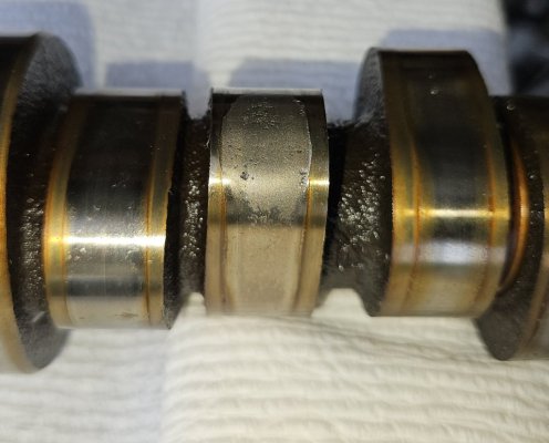

I'm really leaning toward this as well. I believe the penetration of the hardened surface of the cast iron cam is not very deep.
I don't really think the lifter bearings are much of a contributor to the failures,as much as the cam starts to gall,and then causes the lifter roller to skid instead of roll
^^This^^ My failed lifter needles looked decent. It was the pin they roll on that failed.
However, in addition to my failed #5 intake lifter and cam lobe, I had BOTH #8 cam lobes just worn through the skin of the hardened surface. The corresponding lifters still looked and felt good.
You stick a good aftermarket non-mds billet cam and a set of the Mopar valve springs in one, you'd have had to have really pee'd the big guy upstairs off to have another cam/lifter failure :Big Laugh:
I would've bought a billet MDS cam if I could've. I bet it would be much more durable than the cast OE one.
I still have all my removed parts if there's something anyone would like to see.
