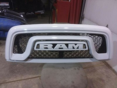

How do you install a Rebel grill on a 1500?

I know you have to remove the lower corners. Any help would be great!

Pull lol thats what i did when i removed mine. There are like 4 clips on the bottom so you gotta do a push and pull. Put your hand on the inside at the puttom and push whilst your other hand is on the outside at the same location pulling. Seems like its ginna snap but its fine

Is it off of an actual rebel, or an aftermarket look-a-like to fit a 4th gen? The actual rebel grill doesn't have the chamfers on the bottom corners, so it may not fit a stock 1500. The rebel has a flat bumper and the gap pieces under the headlights like the 2500 and 3500.
