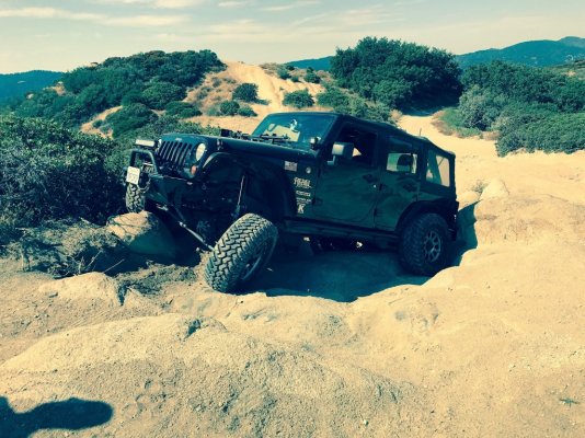

They're nice shocks, i had the Fox 2.0's in the back of my Jeep replacing 5100's, a lot better than 5100's in the dirt because the Fox are valved with dirt in mind, it'll be the same deal in the trucks, get the performance series, not the adventures ones, not that much expensive, and the performance series have better seals inside, can be revalved, rebuilt and have aluminum body.
Check MaxTrac or CST for your performance options, they might have a kit that will suite your needs.
35420601904_2fea9584fc_h.jpgUntitled by Wrangler RSM, on Flickr
34785293595_ead4d5732f_h.jpg20170520_161151 by Wrangler RSM, on Flickr
OME replaced the front 5100's, again, another shock valved with offroad in mind
