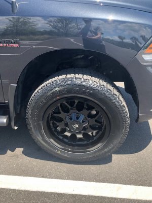

If you want to slightly taller and wider, I suggest going up to a 295/60-20 with a 20 X 10 wheel with a -12 to -18 offset. Mine are -12:
