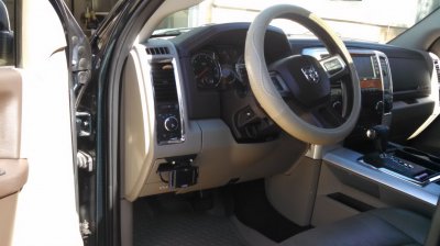

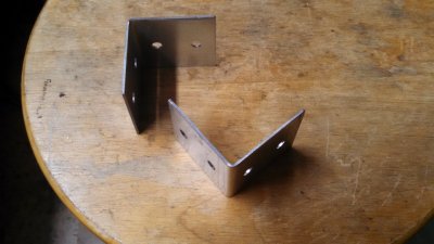

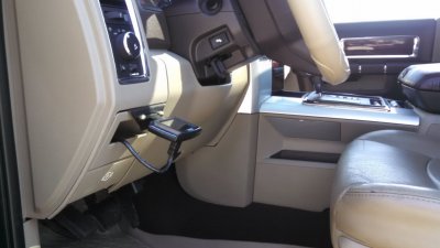

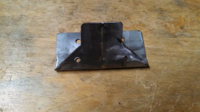

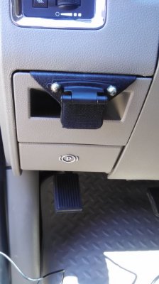

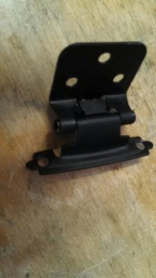

I'm not sure if this post belongs under interior or not but since its about the mounting I'm starting here. I wanted to mount my bullydog tuner but didn't want to drill holes in my truck and couldn't see paying 100 bucks for the pillar pod and bully dog mount...so I did this. I started with 2 pieces of 90 degree steel corner brackets I found in the garage from a shed install..i brazed them together to make them wider and then trimmed the side showing for a better more streamline look.This slides into the truck above the E-brake . I then got a bracket for kitchen cabinets and notched it around the hdmi port on the bullydog and used a heavy duty 3m scotch lock on it.I mount the bullydog to the plate I made and run the HDMI cable thru the storage pocket that I never use..yes I had to make a hole in the rear of it but when I sell the truck or remove the bullydog a piece of gorilla tape will fix it.. With this mounted on the cabinet bracket it drops down flat out of the way..it tilts up for easy access. I don't need to be looking at it all the time since my evic has all the info I need anyway.....heres the making of the bracket...and below the unit itself mounted to it

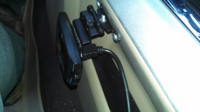

and the unit mounted to the bracket....
The 2 gold acorn nuts will be replaced with black ones...those are all I had on the shelf at the time...

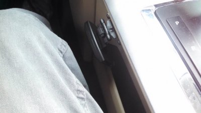

Here's a better side view...it's easy to program and see when tilted up....WHEN YOU'R PARKED. I don't like distractions when I'm driving let alone getting "on it" when blowing the doors off some young kid in his fast and furious rice burner :)

Have fun banging your knee on that thing getting in the truck. I have completely f*cked up my sub level knob being mounted there in that location and it barely sticks out of that cubby hole.

I don't even come close to hitting it...and I'm 6ft/ 230 ...when folded down its almost flush anyway and follows the slant of the dash...and its mounted so if something did hit it ,it will swivel. Theres no bolts holding the mount in place in slides in the gap above the E-brake so that if something were to hit it, it would have the ability to move...Heck I've been modifying and doing creative mounting since the 80's when I use to install car phones for Cellular One and tend to look at things from all angles the way a snobby customer would... No this is pretty much perfect for my needs and it doesn't trash up the truck. No downside at all . . . for me
