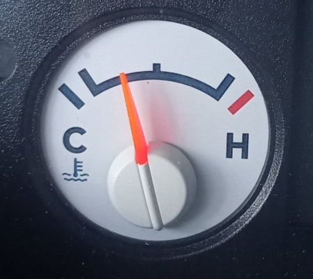

The picture shows the gauge when at normal op temp, at idle after driving, the meter doesnt go farther. It moves a little when heavy hauling but otherwise thats the position it always is in.

Guaranteed even after that 4 miles at speed it isn't "up to temp", it's just up to temp enough to move the gauge (the temp gauge in the 3rd gen doesn't really show anything) and allow the trans to have OD available. Letting it warm up a bit helps in these situations though you haven't said how far the drive is. If the engine doesn't get consistently driven far enough hot enough (to evaporate the condensation out of the crankcase) things can start to sludge up, especially if using cheap oil. The important thing (that the engineers don't bother to tell anyone) is getting the oil temp up to where it needs to be.

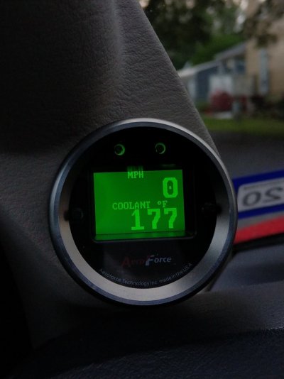

The sensor itself reads actual temp (the PCM uses it) so if you have something that can read off the OBD port you can see what it actually is. I like knowing what both my engine & trans temps are (plus the digital speedo closer to face level is nice) so I went with this:
My gauge sits in the same spot.I have a 190 t stat.
