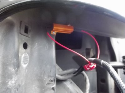

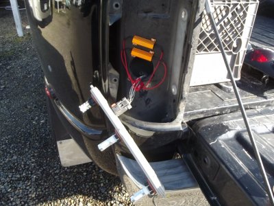

DSCF2130.JPG DSCF2163.JPG 6 watt 50 ohm resistors-you'll need 4 just for the rear (2 each side) and 2 more for the front turn signals. It's a simple job but definitely mount the resistors on a metal surface because they will get hot when in use. I'll attach a couple pics to show what I did.
