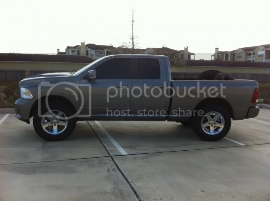

You can run the 295/65R20. I ran that setup on stock wheels with a positive offset with a 2" level. I had only very minor rubbing on the sway bar at full lock (only time it rubbed was if I was trying to park).

Man, your truck has come a LONG way

Before I posted that picture I looked over it top to bottom to see the all the things that have changed....yeah a lot!

Not anything to do with the tires but do you have any pics without a load in the bed of your truck? I want to see the rake of your truck with the 1.5" rear lift. I'm wanting to do the same to my truck..Thanks

I think Kevin only ran a 2" level in the front, no rear spacer.
